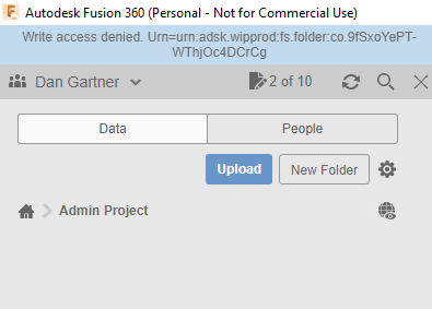

I am running into an issue where I can not save any files. I get this notice when I log into my account online
I can not find any information on Fusion 360 Personal license and how long Autodesk A360 Team will allow you have your account.
In Fusion 360 when I attempt to start a project, I get this icon.
Those blue circles never stop.
I also get an error when trying to export to STL.
I think the key to this issue is shown when I try to do anything with my admin folder.  It says, "Not Authorized", like my account is locked.
Example of me trying to create a new folder in my Admin Project
I get a blue message at the top.
I just downloaded Fusion 360 for the first time today.  Any ideas on how to fix my A360 team account so I can use Fusion 360?
