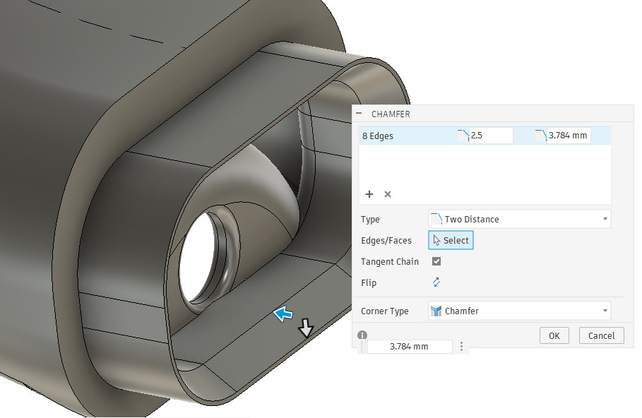

I’m modeling a vacuum adapter in Fusion 360. It’s a lofted elbow that transitions from a circular bottom to a rounded-rectangle top.
When I try to Shell it at 3mm thickness (inside direction), I get: “The shell cannot be created at this thickness. Try adjusting the thickness, the selection set, or change the shell type.”
Details:
  • Lofted body (not mesh)
  • No mesh conversions
  • Thickness desired: 3mm
  • Shell fails even when selecting only one open face
  • Geometry includes a curved elbow transition
  • Some fillets exist after the loft
I suspect the inside offset is self-intersecting in the tight bend area.
What is the proper engineering approach here?
Is it better to:
  1. Shell before fillets?
  2. Use manual inner loft + Combine cut?
  3. Modify loft guide rails?
  4. Something else?
Or maybe none of these are the solution. I just need help, I am new to fusion 360 and put a lot of effort into this thing, and don't want to have to redo the whole thing.
I’ve attached the .f3d file.
Thank you.

Man these are great, i am following along and doing everything as you do it. I believe you skipped a part in between the two first sketch profile videos. You missed how you created the second revolve that we decided is straight and not starting to curve down yet. A video for that would be great. Or maybe I can try it myself.

I realized that I forgot the Chamfer in the video.
One hour of videos to model the part.
Attach your progress file here.

Ok Great! I am done. However I would like to know the best way to engrave "VW GDI" into the face. Like my old one. That's the very last thing to do. Letter height is 5.5mm

I made one adjustment to be more close to the original. Edited it so that the loft started from a smaller circle, and then chamfered the two different sized circles.

Alright well I'm done. Thanks again, this was a huge help! Also one more question, I have a bunch of other adapters I need to replicate and re-engineer into CAD. There are all different shapes and sizes. Do you recommend I go about them the same way we did with this one? Go off the 3d scan for reference?
