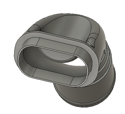

I’m modeling a vacuum adapter in Fusion 360. It’s a lofted elbow that transitions from a circular bottom to a rounded-rectangle top.
When I try to Shell it at 3mm thickness (inside direction), I get: “The shell cannot be created at this thickness. Try adjusting the thickness, the selection set, or change the shell type.”
Details:
  • Lofted body (not mesh)
  • No mesh conversions
  • Thickness desired: 3mm
  • Shell fails even when selecting only one open face
  • Geometry includes a curved elbow transition
  • Some fillets exist after the loft
I suspect the inside offset is self-intersecting in the tight bend area.
What is the proper engineering approach here?
Is it better to:
  1. Shell before fillets?
  2. Use manual inner loft + Combine cut?
  3. Modify loft guide rails?
  4. Something else?
Or maybe none of these are the solution. I just need help, I am new to fusion 360 and put a lot of effort into this thing, and don't want to have to redo the whole thing.
I’ve attached the .f3d file.
Thank you.

TheCADWhisperer
@tscarrott07
I made some quick changes to your model and then Shelled first at 1mm to make sure it would shell and then at 3mm.
It is getting close to my bedtime - so check back tomorrow to see how I would model this part.
(I might get a little done on it tonight.)
