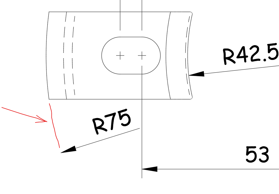

Small irritation here. Can someone explain how I get the extension lines to appear as per the crudely drawn red line in the image?
Also, why is it, after I've placed a dimension, I then have to escape out of the dimension to move it if I've placed it incorrectly? 1 too many clicks again! Also, why will the dimension text not follow the cursor when placing a dimension? You have to place it, then exit, then click again to move it! If you don't exit from the command you end up dimensioning a dimension!! Why would that even be a possibility!?!?
So many irritating features with the drawing side of fusion, I'd love to write them all down for someone to fix!

I can verify the issue you have presented in your Forum post and it needs to be taken care of.  @CGBenner, would you please move this post to the Fusion Support Forum.  @Phil.E, I do not know who is heading up the 2D Drawing issues since Clint Brown moved on but would you please get this issue to whoever replace him.  Thanks

This post is not about a feature that needs to be added to Fusion, it is about a feature that was there and has been lost!  Somehow the ability to extend extension lines for a radius callout has been removed.  If you use a Jogged Radius dimension it still works so that should tell you something.
