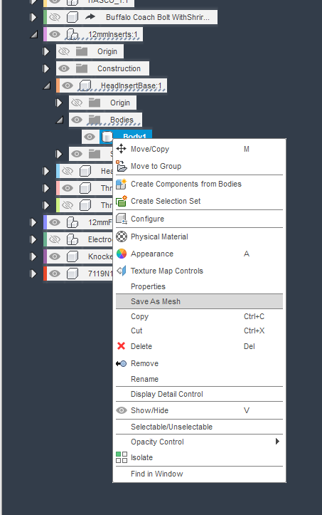

I’m wanting to Use the Autodesk Fusion app to export my designs in to .3mf files to slice and print from my phone. I’m just wondering if it is possible

You can right click components or bodies in the browser and select save as mesh.
On the mesh dialog select 3mf and set refinement settings.
