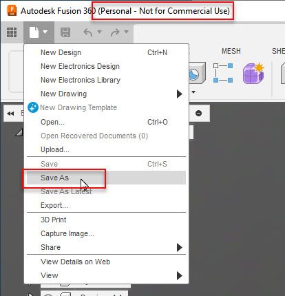

jhackney1972
As you can see from the screen capture, the Save As command still exists in the Fusion 360 Personal license.  You must have a model open for it to be available.

HughesTooling
@jhackney1972 Does it make any difference if you already have 10 designs set as editable? Do you need 9 or less editable designs for this to work?

jhackney1972
If you have 10 of 10 editable documents, the Save As command is unavailable.  You have to have 9 or less, in a Fusion 360 Personal License, to save a new file by any method to the cloud.  The screen capture below is with 10 of 10 editable documents indicated.  Export to your local drive is, of course, still available.
