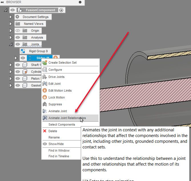

In https://a360.co/428f4BQ I cannot make the components shaft, piston, and gasket slide all together inside the cylinder.
Appreciate it if you could let me know how!

problem is that the Joint (Slider 11) acts only on the piston, and the shaft and gaskets stay in place. I created the Rigid Group (Rigid Group 9) but it's not working the way I want to.

If you animate Slider 11 joint, you see that only the piston moves. Shaft and gaskets stay in place.

You are using the wrong command to animate your Slider 11 joint.  You are using Animate Joint, you should be using Animate Joint Relationships so the your Rigid Group is picked up by the motion.
John Hackney, Retired
Message 10 of 10
mahdi_razazTJN78
Perfect! Thank you!
