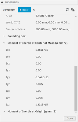

So I wanted to calculate the moment of inertia matrix about the COM of one of my parts. I decided to do a sanity check by comparing it to the moment of inertia for a cube. From sources I know that the moment of inertia of a cube is diagonal. but I am not obtaining that from Fusion 360. I get the following:
I then decided to compare this with Inventor and I did end up obtaining the diagonal:
I also compared it with another CAD software and sure enough I got the what I expected
To my best knowledge I modeled this cube the same way in all 3 programs.  So I was wondering if I made a mistake in the modeling or if I am interpreting this data incorrectly. I have attached the Fusion 360 file I used to calculate the moment of inertia as well.

Hi @Anonymous,
I agree the products of inertia should be zero for a symmetrical body. It's logged in our system and sent on to development as ID 55088.
We appreciate you bringing this to our attention, and apologize for the inconvenience this is causing.

I don't know if this will also help out.So I believe this is an issue when right clicking on "Bodies" and selecting "Properties". When I right clicked on the "Component" and selected "Properties", I actually did obtain obtain a diagonal matrix.

Aha!  Thank you for noticing the component properties are correct.
I've added this info to the issue ticket, it may help us diagnose the cause and remediation.

Hi @Anonymous,
Development has arrived at the solution. You'll be able to see the correct behavior in an upcoming Fusion update. However, it won't be for a while...it's looking like it'll be available towards the beginning of the spring season (for those of us in the N. hemisphere).

The issue remains for bodies? The problem seems to be when you move the bodies from the center of mass to the origin, for components it seems that it works just fine. For bodies it calculates the moment of inertia at center of mass a bit wrong but hey it is close to the real value so...

Center of Mass 500.00 mm, 5000.00 mm, 1000.00 mm
Moment of Inertia at Center of Mass   (g mm^2)
Ixx = 1.361E+15
Ixy = 0.048
Ixz = 0.012
Iyx = 0.048
Iyy = 6.542E+13
Iyz = 0.095
Izx = 0.012
Izy = 0.095
Izz = 1.321E+15

Hi! Many thanks for reporting the issue! I tried it on my machine and I got slightly different measurement. For the box away from the origin, Moment of Inertia at Center of Mass, Ixy, Iyx, Ixz, and Izx are all 0.00, while yours shows some minor deviation.
Please share the f3d file here. I would like to take a look to understand the difference better.
Many thanks!

Update: The problem seems to have been resolved in April. I have consistent results with product of inertia = 0 for symmetric bodies and components as well. Not sure if the fix is universal or not.
