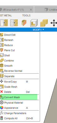

g-andresen
1. Finish Direct Mesh Edit
2. MODIFY Convert Mesh

After I "Finish Direct Mesh Edit"  I go to the Modify pull down and I don't see the "Convert Mesh" selection/option.
Here is the Modify pull down pre "Finish Direct Mesh Edit"  and post exit.
neinspam2XVWZ
Ahhhh! light bulb goes off.  I needed to select the Mesh work space tab after I exited.  By default it was in solid space after exiting.
