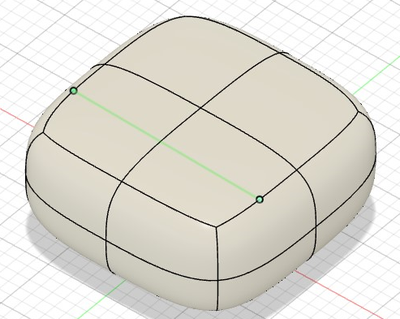

Hi all,
I updated Fusion 360 yesterday, and now the "Insert point" command no longer seems to work when I edit a T-spline form.
I found a Reddit post which describes the problem well, but didn't find anything about it here in the forums, so I quote:
"With the new update my insert point command seems to be busted. I can’t get lines to project onto the geo unless I place a point on each individual edge. But this is slow and creates bad topology. If I try to project a line over multiple edges all that’s created are the start and end points with no projected line between them. This also creates points all over the form creating unforeseen errors."
(Quoted from https://www.reddit.com/r/Fusion360/comments/xa60pe/issues_with_insert_point_in_sculpt/)
Has anybody else experienced this?

@TrippyLighting Can you create a Plane or Cylinder and try Insert Point Simple?
Regarding the Box case in your video, can you rotate the Box before you hit OK on the Insert Point dialog?
Glenn

So, my Windows version was on 14335 when I created the screencast in my last post.
Obviously I had to shut it down to start it on my Mac.
My mac was not yet on 14335 so it needed to update.
Once it updated and restarted I performed the same test and it also failed to insert points across one or more bridged edges.
Now that I shut my mac down and restart Fusion 360 on my Windows machine it has to be updated to 14336!
But it still does not work.
When I add a point as shown in the screencast, bridging the center edge while in box view mode it does not insert an edge. However, when I do the same thing in smooth view mode it does insert "something" as I can see the shape changing. But it does not visibly add an edge. Neither in smooth view mode, nor in box view mode.
Regardless whether I rotate the model after selecting the edges but before hitting OK.

@TrippyLighting Version 2.0.14335 went live last evening, and 2.0.14336 went live this morning.
Thank you for verifying that Plane and Cylinder work.
I reproduced the issue with Box in the default isometric view. In that case, two new vertices are created, but edges are not. If you orbit the Box before you hit OK on the Insert Point dialog, you may see new edges created. In other words, new edges may or may not be created, depending on the camera view. Since this can be viewed as flaky behavior, I logged this issue as TSP-4314. Peter, thank you for reporting the issue.

It is more then just "flaky". You are correct that vertices/points are inserted, but only on the selected edges, not in the bridged (but not actively selected ) edges. That means for example they cannot be selected for editing.

This bug has been fixed with the October 2022 update (V.2.0.14567).

Hi all,
Have not had the opportunity to test this before now, but can confirm that the issue is indeed fixed. Thank you!
