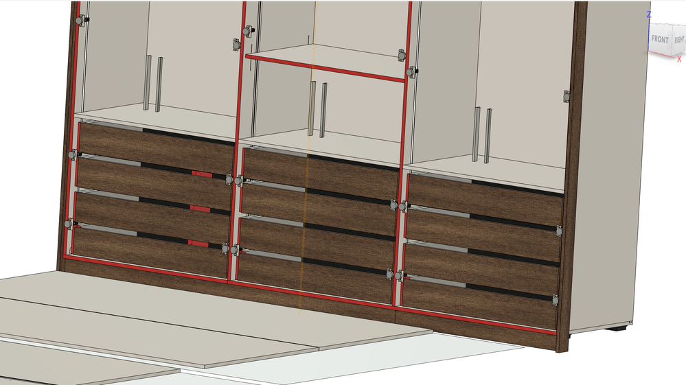

Thanks for the model.  Can you point to which faces here that are showing the wrong appearance? (I made the doors invisible):

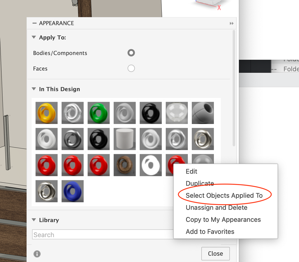

2.  In the appearance command, if you click on an appearance, and right click, and choose "Select Objects Applied To", it will do just that:
Here is what I get if I do that for "Powder Coat (Red)":
I didn't see any that looked obviously wrong, but I admit I did not look all that hard.

to3dornottobe
The edges on the drawers behind the doors have assigned, but invisible, red faces to the outside contour
