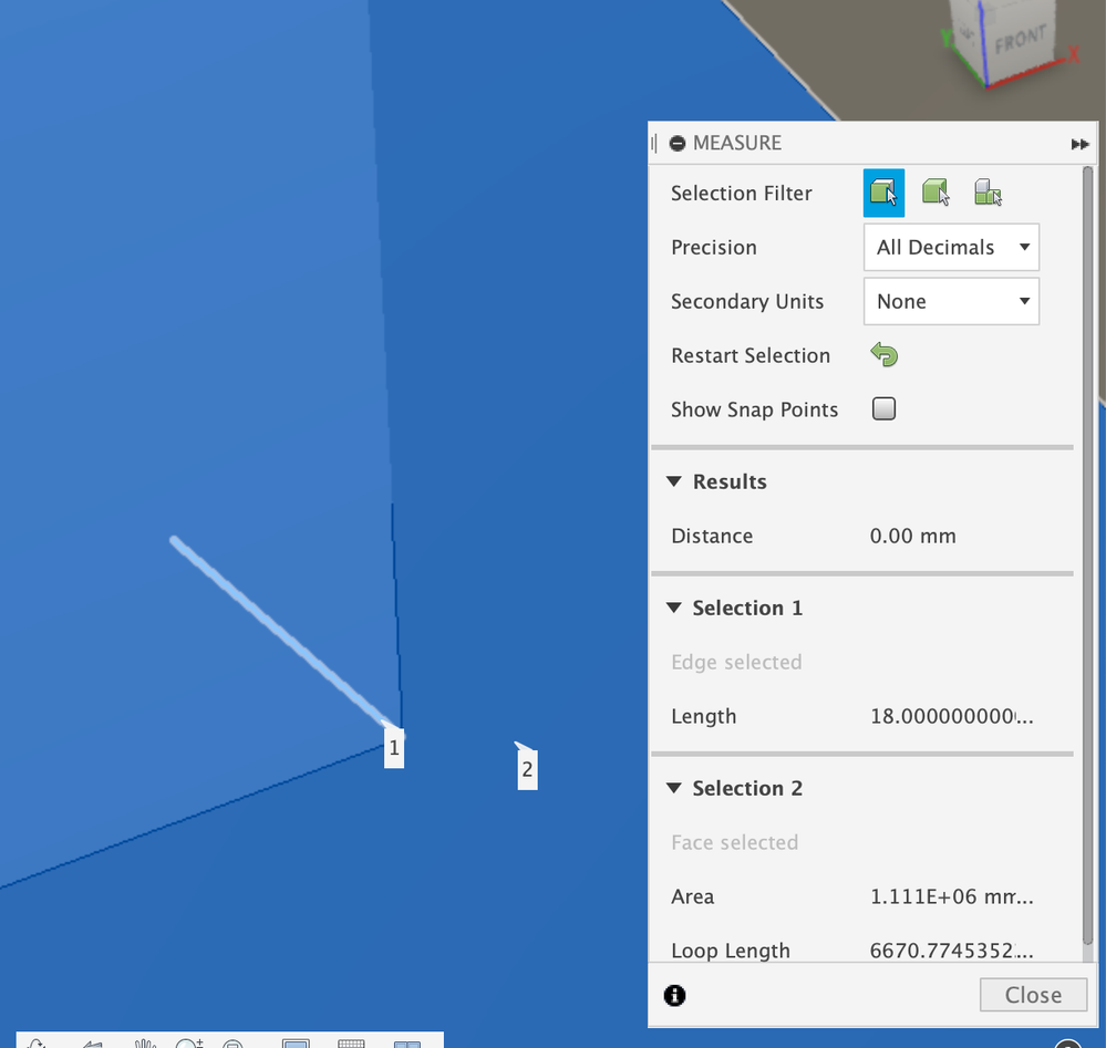

@HarrisonClassic - heard back from the kernel guys.  They think the error might be related to these small edges in the body:
it sure seems possible that this is the case, since those happen to coincide with the two pieces in the "line 3" folder of the "TR" component, that you narrowed down to the ones that caused the problem:
I traced those lines back to the Combine86 feature in FR in the timeline:
If I roll back before that, and do a measure between the bottom edge of those pieces and the bulkhead, I see that there is zero distance (i.e. the edge is exactly coincident with the face of the bulkhead, and the Combine leaves this standalone edge imprinted:
That's as far back as I traced it, though.  I did not look at how those cross-pieces were built, but I suspect that some adjustment could be made to those to prevent this.  Since you are able to move forward, though, I'll leave it there for now.  I'm not sure what to tell you about how to prevent this in the future, (this points to the need for some good body checking tools in Fusion), but I thought I'd pass along what I found out.
