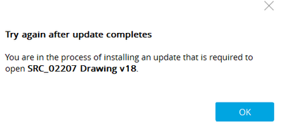

We are also experiencing issues where team members are unable to open drawings for parts in Fusion as Fusion is insistent that the  user is in the process of installing updates - the official line is "You are in the process of installing an update that is required to open...." The only option Fusion gives it to click "OK", this is not "OK". The users are not knowingly installing updates and as far as I am aware they have no way of deciding when or if updates happen. The updates process with Fusion has always been automatic in the past. Has this changed?

A more pressing issue now are the drawings that  cannot be opened by any users. It feels as though these files may have been corrupted. The warning that comes up suggests that there is an update happening, however I refuse to believe that an update would take over a week to load. I have included a snip image of the warning. It would be good to get a resolution to this problem soon. We currently potentially at risk of creating more drawings that we are then unable to access, which is wasted time and effort.

The first question should be, is this for all drawings or just some of them?
That error is not one I have seen previously, so I am not sure what is causing it. It is a bit of a hassle, but on one of your systems you might try a "clean" uninstall, then reinstall, of Fusion, to see if that makes a difference. Here is an article on the steps to do a "clean" uninstall.
https://knowledge.autodesk.com/support/fusion-360/troubleshooting/caas/sfdcarticles/sfdcarticles/How...
But before that, you might try clearing your local cache (Clear cache data). It could be that the problems you were having with the reservation system have left some problems behind that are only impacting drawings (though not sure why). I would restart Fusion after this, just to really clear things out.
Sorry I don't have a more definitive idea of the problem and solution, but let me know how it goes.

Thanks for your help. I have tried to clear the cache and the problem is persisting. I have also asked a colleague to access the problem drawings and they are unable to access them. It appears that all the problem drawings have either been created or edited by one specific member of the team.  I will try the uninstall and re-install option, but really wish I didn't have to mess about like this. For reference this is the warning.

A fresh install of Fusion 360 seems to have resolved the issue. I am now able to open at least a couple of the drawings (I have only tried a couple so far). It is odd as I thought Fusion was supposed to update automatically? Any way thanks for your help.
