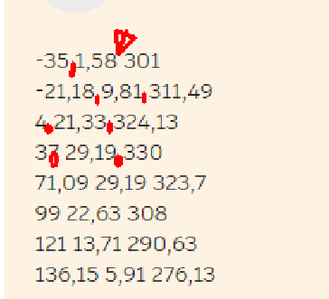

@jmpframce Can you share an example of the csv file you're trying to import? You might need to change the file's extension to txt to be able to attach it to your post.

jmpframce
-35 1,58 301
-21,18 9,81 311,49
4 21,33 324,13
37 29,19 330
71,09 29,19 323,7
99 22,63 308
121 13,71 290,63
136,15 5,91 276,13

HughesTooling
Can you just attach the file as a txt file.?
Looking at what you have posted the format looks all wrong. Some lines have 4 numbers and the comma is missing between others or have you just typed it incorrectly?

JeromeBriot
@HughesTooling Because this is not a .CSV file (i.e. Comma-Separated Values) but a .SSV file (i.e. Space-Separated Values). Even better, a .SSVCDS file (i.e. Space-Separated Values with Comma as Decimal Separator).
