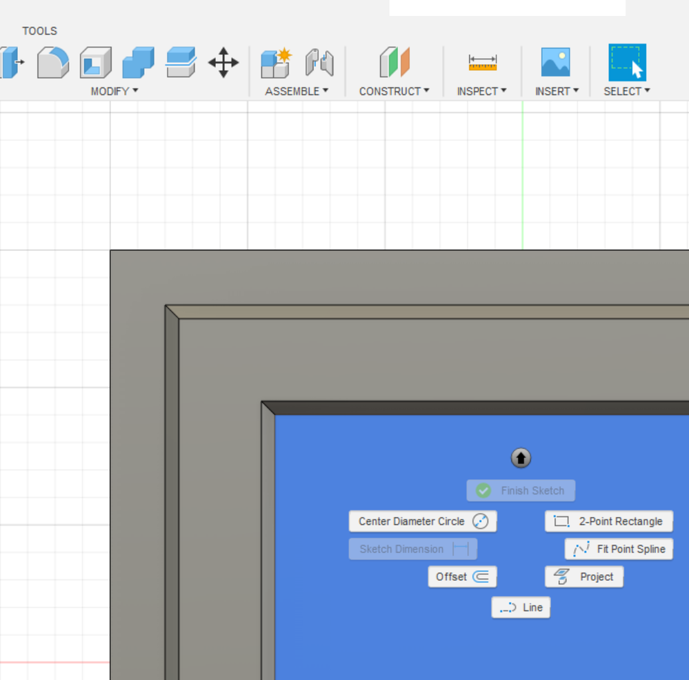

WattyRev
Community Visitor
Community Visitor
I'm trying to follow these instructions, but when I click to add the text, the "Text" window doesn't appear. Am I missing something?
Here's a screenshot of what it looks like after I click on the sketch area to add text:
Message 15 of 26
TheCADWhisperer
Have you been using dual monitors - could it be on the second monitor?
What version of Windows are you running?
Have you tried restarting Fusion and the problem persists?
Have you tried rebooting the computer and the problem persists?
Is this problem observed only on this file or is it observed in all files?

Message 17 of 26
WattyRev
Community Visitor
Community Visitor
That must be it. I had originally opened Fusion 360 when I had external monitors connected. When I tried using the text, I had disconnected the monitors. After I restarted Fusion 360, the text window started coming up.
