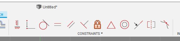

Additional sketch constraints can be added by selecting them from the "Constraints" tool panel.  In the screen capture below I am showing you the new UI Preview Fusion 360 environment.

You can prevent a sketch constraint from being automatically applied by holding down the Ctrl key when you are picking points in your sketch.
