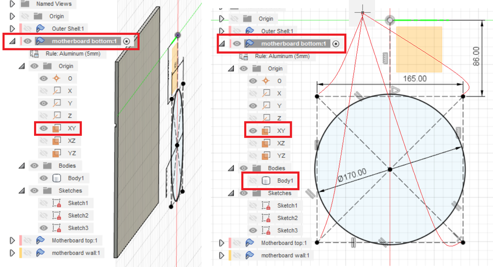

Okay, I'm back working at it today. I have the outer shell you made, the bottom, top, and inner wall made. Now I want to make fan mounting holes in the motherboard bottom component. My previous attempt left nothing but an unconstrained mess. See motherboard bottom sketch3 of computer try again v12.
I started off by marking where the 540mm fan area would go with the line tool. then I made the area and each circular cut our and marked the screw hole positions. Finally I extruded to the depth I wanted. What method would you recommend to do that properly/correctly/efficiently?
Message 28 of 43
I Tired to continue, but I still got blue lines and white dots. Please advise.
motherboard bottom sketch 3

TheCADWhisperer
Use the Origin Planes (rather than body faces) whenever possible and practical to create sketches.
Do not repeat sketch geometry (you will need only ONE fan sketch).
Place sketch points at the four corners of the rectangle (these will be used for Hole features later).
BORN TechniqueBORN Technique
...and make use of obvious symmetry.
Message 30 of 43

That is what I always do. But then I get blue lines because they are not constrained. How do I create the rectangle 86mm away from the origin?
Message 33 of 43
TheCADWhisperer
Dimension it 86 from the Origin AFTER creation.
Imagine you are sitting in a car.
There is a driver that determines where the car goes (your design) and the passenger(s) (sketch(es)) that are merely along for the ride.
Parametric dimensions in Fusion are DRIVING dimensions.  Add the driver and the sketch geometry is along for the ride-it goes where the driver makes it go.
Message 34 of 43

TheCADWhisperer
From your posted image - I made the prompt for next step larger...
