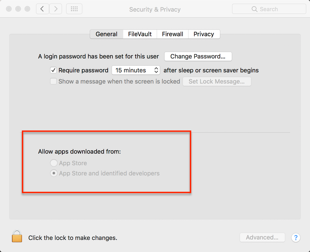

Phil.E
@Anonymous
Sorry to hear this is causing trouble for you. It doesn't appear to be a general problem for all users, so it might be a problem local to your user/machine and your permissions/settings. I'd like to help you here to get connected with Fusion and Meshmixer, and also find out if there is a new problem in Fusion we don't yet understand.
Looking at the warnings, did you follow those instructions? It sounds like you have the same issue reported earlier in this thread. So I'm wondering if the instructions are failing, or if there is a new problem. I cannot reproduce any problems in my test macs, but I have full admin rights, and also allow use of apps from other than appstore, so I might not see the problem as you are.
This is my security setting, is yours set like this?

Message 19 of 26
Hi Phil,
I have admin privileges and setting to instal all apps. I have opened Meshmixer (latest version) manually but is still does not work. It used to work in the past…
See attached screenshot.
[cid:D05A30AC-E45D-4270-B923-6352FE17269A]
