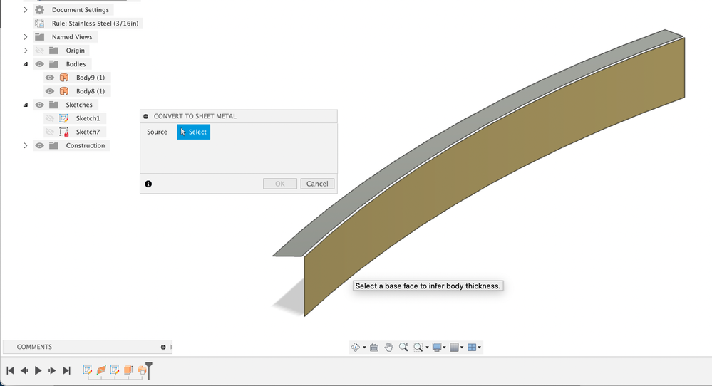

maybe that's what I'm missing, what do you mean by "create offset"? I don't see that in the timeline at all. sorry for all this back and forth, I have 5 of these pieces to design to fit the full length of this pool edge and they all have different dimensions so I need to know how to do this start to finish

My mistake, not Offset,
but Surface Extrude -> Create SM Component (activate) -> Thicken, as New Body, Convert to SM and
Sweep -> Create SM Component (activate) -> Thicken as New Body, convert to SM.
Create Flat Patterns.
I use Create Offset a lot and misread the icons.
Might help....
Message 20 of 25
so this still doesn't make sense. per your timeline which I can follow until the sheet metal:
Create sketch, create offset plane, create sketch, extrude vertical curved face, sweep angled face, magically make sheet metal???
