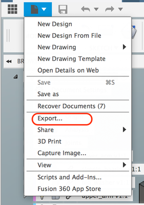

A distributed design is a design that has linked/external components in it.
If you use the export option available through the file menu as @HughesTooling has already mentioned the assembly will export fine as a .step. At least it works on my machine.
