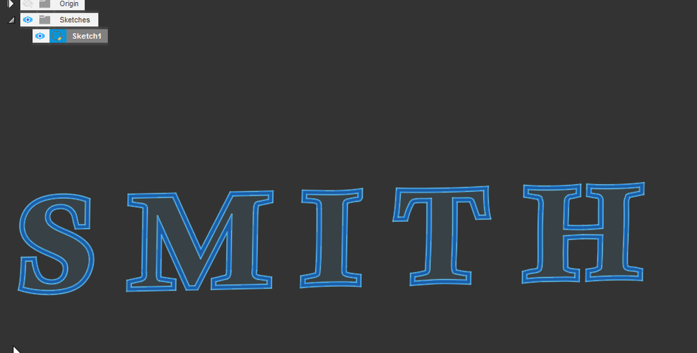

hey mark. i'm having the same problem. my work has a plasma cutter we can use to do stuff for home. so i'm trying to cut out my last name "smith". i imported a pdf (from excel) then i sketched around the letters with the fit point spline toolScreen Shot 2020-08-21 at 5.27.43 PM.png, removed the pdf image and added an offset. the nesting program for our plasma is fast cam. once i export the dxf and it gets loaded into fast cam. there are gap in the corners and extra lines in odd places. i don't have a photo of this currently. any suggestions? this is also occurring when importing that dxf to other cad programs

1. Fusion has no objections to the sketches
2. V-carve identifies errors in M, I and H > has been repaired (connected)
3. finally, I roughly aligned the letters and converted them into arcs/straight lines (tolerance 1/100 mm) > 1 sketch
4. exported as DXF and imported in Fusion

No not a Fusion problem. First I exported each letter then reimported into a new design and all profiles are still closed.
Then I exported that single sketch that contained the imported letters, opened in Rhino and Rhino also closed all the curves into closed profiles. i've attached the Fusion design with the imported letters.

so i had a look at the the file you sent back. immediately i have noticed there isn't little black dots on the corners and points through the curve. I'm going to assume those black dots were problem points.
were there gaps in rhino when first imported? and rhino fixed it? thats what i took away from what was inside the red box. fast cam can do that but with this situation there was to many gaps for it to automatically fix.

The black dots in the initial design are spline points not problems. When Fusion exports the splines they are converted from fit point splines to control point splines because DXF does not support fit point splines.
No I did not fix the curves in Rhino, they come in as individual curves, all i did was join them. If there were gaps they would not join. The Fusion export is not a problem, fusion reimports the curves without gaps and Rhino reads the file without gaps. There are a lot of CAD programs out there that can not read splines higher than degree 3, there are several degree 5 splines in your file, that might be your problem
