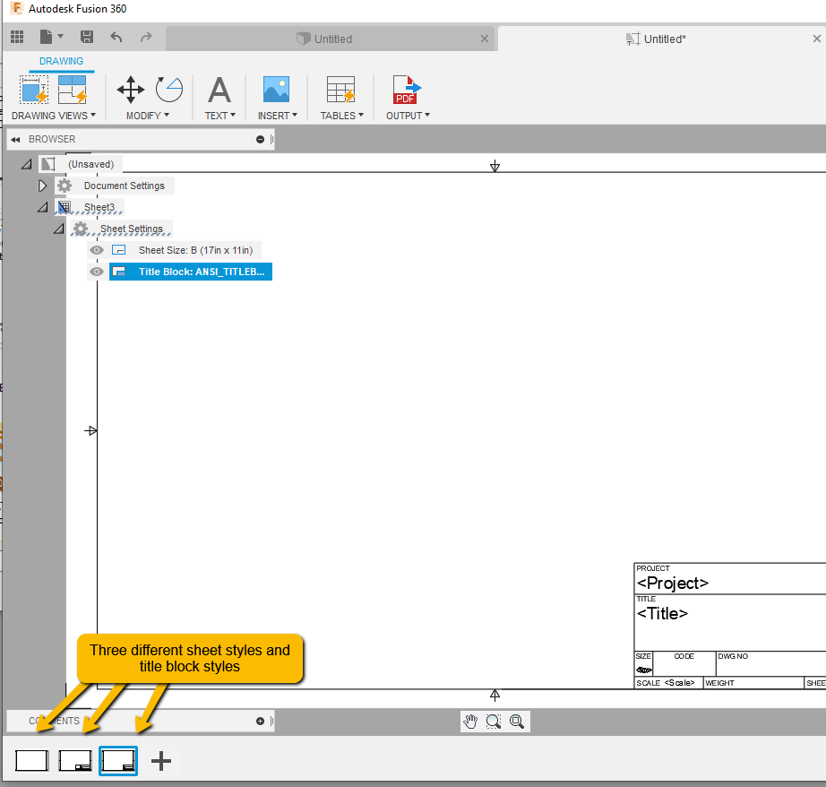

This should be possible using Fusion drawing templates.
First, please read the help section with all the details about templates and drawings:
http://help.autodesk.com/view/fusion360/ENU/?guid=GUID-7D66F0CF-97BD-4EFB-9EB2-37CF89F76C56
When you use File > New Drawing Template you can define a template with as many different sheet styles as you need. In this image I created a simple example, The first sheet has no title block, the second sheet has the default title block, and the third sheet has it's own unique title block. There is no limit to the number of sheet styles and title blocks you can use in a template.
Have you tried this?

jon.hobsonDXEF8
Thanks, that's worked a treat 😀
