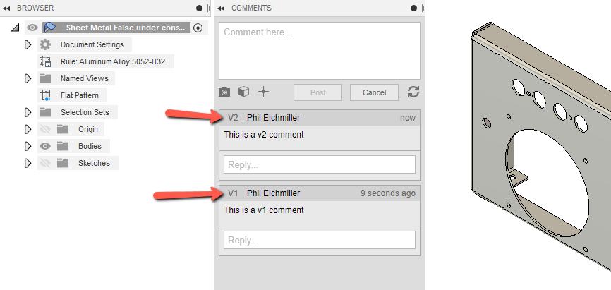

Great question. At this time there is no way to edit old version labels.
One workaround for you would be to add comments to the design file.
Step:
Open the old version
Add a comment
Result:
The comment will be marked with the version number.
If you open old versions they cannot be saved except as "latest" which is like rolling back time to that version.

I can't figure out how to do that -- I tried to find out how to do this and couldn't...
Phil.E
The control to open an old version is right inside Fusion's data panel.
After the version is open add comments. No need to save anything. Just post the comment!
Reference blog post about using Version Control.
