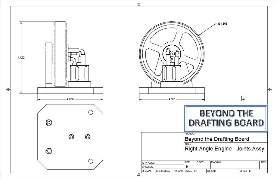

No, I have found that Fusion 360 Web can only do patterns of bodies.  Even though it says it can do Faces, I have not had any luck with it.  You are trying to do a pattern of a model sketch which as far as I can tell is not supported.
As you move forward in your use of Fusion 360, or any CAD package, you need to learn the proper terminology.  When you create a line, circle or any entity shape on a sketch plane in the beginning of your model, that is called a Sketch.  After you extrude, revolve, etc. that sketch you have a Model.  The term Drawing is reserved for the 2D drawing created from the model such as the example below.  In your post you refer to a 2D Drawing but you are showing and talking about a model sketch.
