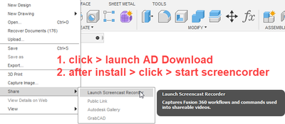

g-andresen
1. share file
2. create screencast
