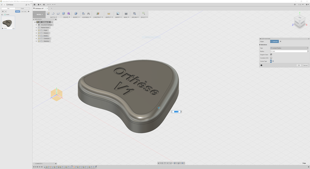

Some updates ago, Fusion360 worked very well on my 4k resolution display and I had a crisp and clear visualization of text and symbols. To achieve this I applied following hint: https://knowledge.autodesk.com/support/fusion-360/troubleshooting/caas/sfdcarticles/sfdcarticles/Adj...
With the current version out (2.0.3133), I can not get a clear, not blurry, GUI. Btw, Fusion runs in an Windows 10 environment, Version 1703, Build 15063.332
I hope someone can help, because it degrades the usability and hurts my eyes ;)!
Thank you!
