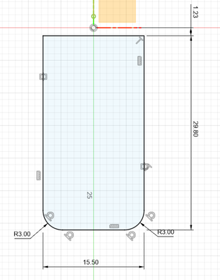

I'm nearing the end of a complex (for me) design and needed to go back to an early rectangle sketch to add fillets.  When I do, the rectangle's location and size, which were dimensioned to the corners are now dimensioning nothing but each other.  Those two dimensions are referenced in many places later in the design so I get a warning when I try to delete them to recreate them referenced to existing points on the rectangle.  How do I re-reference the dimensions without losing the references?

You can see from the images I sent in my first post that the two dimensions on the right are referenced to the top right corner of the rectangle. Then I add the two fillets and the dimensions are no longer referencing the top of the rectangle because the corner has gone away. I just need to re-reference them to the point where the top of the rectangle is tangent to the fillet without deleting them and re-dimensioning, losing the references to those two dimensions later in the design.

no, there is no way to re-reference a sketch dimension.  And yes, sketch fillet can be destructive to dimensions, as you observed, especially if you dimension to line endpoints. If you dimension to the line itself, instead, the dimension should survive.  Here is a simple example:

@siriusphil  I can't get this to fail but looking at the image in post #1 I think you have show points unchecked. If you enable it you should see points at the ends of the dimensions, you can then add a coincident constraint between the lines and the points. Just select the coincident constraint then click the line (not the end point) then click the point at the end of the dimension.

Thanks Mark, that works.
