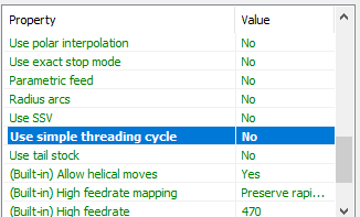

For the threading cycle, the G92 and feed rate output was modified to match other posts using this format for consistency sake.  We can look into removing the codes for the Haas posts, but they should not hurt anything being on every block.
You can enable the G76 threading cycles by modifying the following property when you run the post.
