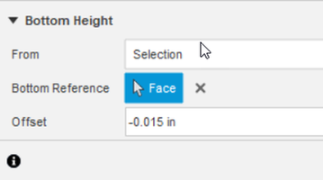

Is there a way to generate a contour toolpath that is centered or "right on top" of a curve?
Within 2D Contour, I only see options for right/left... which makes a toolpath that is offset by the tool's radius away from the original curve. The workaround I have found is to set the tool diameter to something very low, such as 0.00001". However, then the 3D stock simulation is not accurate. I figured maybe I am missing something obvious, thanks in advance for any advice 🙂

I am having the same issue. When I turn compensation off like you showed in this post, the tool still stays to the left of the curve, not on top of it. Not sure why...

Yes, sorry for being so brief. As it turns out, as I was thinking about your response and my reply, I figured out what the problem was!
While I did have compensation turned off, I had used "Selected Contour(s)" for the Bottom Height:
This selection offsets the selected contour whether or not you have compensation turned on or not.
Toolpath is offset to the right of the geometry:
I then picked "Selection" and picked the face that I was cutting on with a negative offset, and the center of the tool stayed on the curve like I wanted.
Toolpath is on the geometry:
