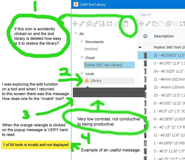

mcd540
in reply to: umesh.bilimoria
The image should speak for itself mostly, but to explain I was checking out the new tool library and was exploring the edit function of an existing tool. When I went back to the main library window there was this orange triangle with a ! in it and a barely readable message. Three steps forward and four backwards is not a victory. Please abandon the low contrast theme, regardless of how popular that format is we want an interface geared toward quick and productive.
One other thing, in regards to the first notation on my illustration, when (not if) the garbage can is accidentally clicked on is the tool library gone forever in an instant, or do we have a chance to back out and save it? I guess I could make a fresh backup copy of the library and give it try, but I have spent a hour to much already on this.
Sorry to be negative, but there are some serious concerns with some of these issues.
Message 126 of 267
MatthewPBryant
in reply to: mcd540
@gtprototype Thanks for bringing up the readability issues you're having. We did make some changes to try to improve the readability, including making text darker and bolder, following feedback from users. Sorry that you're still finding this a problem - I'll be sure to raise it with the team.
@mcd540 It looks like you have an old version of the tool library, you can follow the instructions here to check Fusion is up to date: https://knowledge.autodesk.com/support/fusion-360/learn-explore/caas/sfdcarticles/sfdcarticles/How-d...

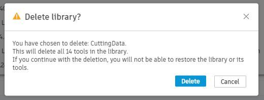

In the latest update, you'll notice that the yellow triangle has gone and we're handling invalid tools in a different way - you can find out more about that on the What's New page. When you click on the 'Delete library' button you'll be prompted with a message to confirm you want to delete the library. If you press 'cancel' at this point, your library won't be deleted.

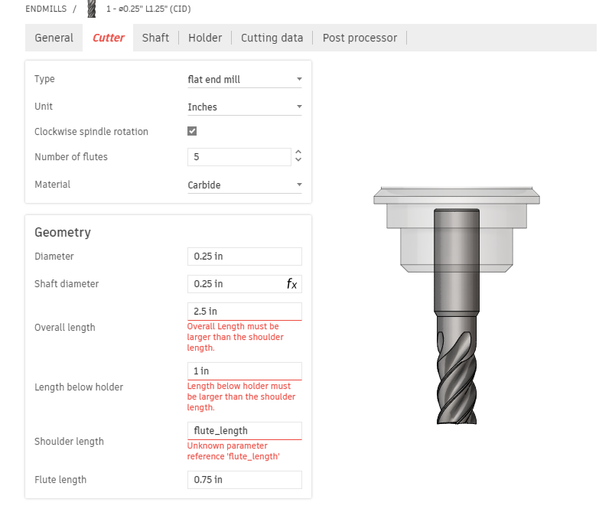

Message 127 of 267
in reply to: MatthewPBryant
The function tool is great, maybe I'm jumping in too early with adopting it but there are a couple of "bugs".
1- Maybe the function should/shouldn't be enabled by default?, but I figured I would make a blank "template" endmill, drill etc. to retain those functions instead of typing them in every time (might as well just input the actual dimension with possibly less keystrokes and less to remember) but unfortunately they don't save with the tool.
2- I also get an error when trying to make the "shoulder length" to reference flute_length and some other errors that don't make sense *see below. Obviously the expression naming I thought it would be is wrong, just took a guess at what it would be.. Is there a list of these expressions documented somewhere?
Not a complaint by any means, just reporting my findings. There have been many ideas thrown out about the new tool library functionality... Some good and useful to put as priorities and some can be set further down the list for future improvements. The Fusion team must document everyone's ideas and input and prioritize them internally, maybe a good idea however possible is for Fusion to publish some of those ideas and create a voting poll where us users can vote on those ideas and have the Fusion team prioritize updates that way?? It would help sort through the data and have the team not get bombarded with too many ideas without practical user guidance on improvements.
