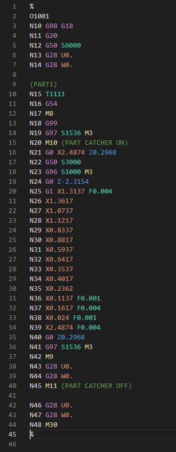

I'm having an issue with the fanuc turning post to disengage the parts catcher. I defined the parts catcher engage(M10) and disengage (M11) variables within the code just was the link shows. The issue I am having is during the disengagement , the post is writing a M10 command instead of M11.

j.mitch97
Hi @erikhardy339
It looks like I've managed to sort this one out, please do be carful when testing this out! I'm not familiar with turning and there codes.
please do let me know if this works.
all the best,
Joe

erikhardy339
Hi Joe,
Yep you nailed it, really appreciate it. Have a great day.
