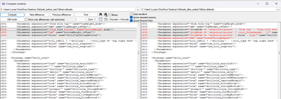

ltomuta
I have just saved new defaults for the drilling operation (expressions linking parameters in the heights tab with hole's selection mode) and the new defauls were saved correctly and still available after restart.
Defaults exported before the test and after restaring show the changes as still present:
Tested with the latest build, on Windows 11.
If you are still seeing this issue you should provide more detail. Like which exact parameter you have saved a new default for and what that default value/expression was.
Defaults exported before/after restarting the app would also help.
