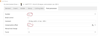

Message 2 of 14
No need to edit post, just use post processor tab in tool definition.
Message 3 of 14
jonathanBUCVS
I understand how to change the offset for the tool. When the entire program posts, the top of the program is a header that contains the tool list as comments. This is the part that is overwritten if there are tools with the same T number but different offsets.
Message 4 of 14
Ah I see, I overlooked the real issue, so I tested small file with T0404 and T0414, results in only T0404 in program hedder but T0414 is in second operation as expected, I tested 4 different posts, same result.
Good enough for me but if you wanna show both, then yes, post will need to be edited.
