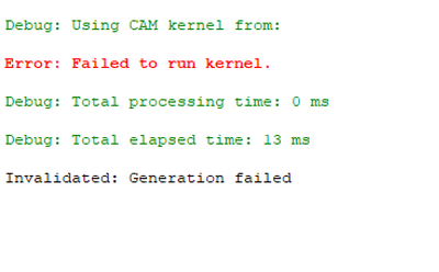

RepackRussian
Got this error message while trying create a milling toolpath. That also happens when trying to create simple milling toolpath (circle in square).
Error: Failed to run kernel.

Hello! I run fusion 360 on windows 10!

RepackRussian
I also found difference between two different PC's
PC in my University Where i trying to use CAM Workspace
from my pc
Fusion doesn't see the cam kernel folder
Message 5 of 10
jeff.pek
Hmm. Can you look in the folder %localappdata%\autodesk\webdeploy\production, and tell me what's there, and whether there are differences between the 2 PCs? In particular, look at the Application/CAM360 directory that's called out in the 2nd message.

RepackRussian
Difference between 2 PC's is just hardware, same windows 10.
In %localappdata%\autodesk\webdeploy\production folders named like "e69ac0f55aa8512db83c718906bbdedf0daa2f89".
In C:\Users\"Username"\AppData\Local\Autodesk\webdeploy\production\a92224e805924f40fe2f5cb1ea196540cf83211e\Applications\CAM360 there are no "camkernel.exe", it was deleted somehow, only camkernel.dll.
 I think Fusion 360 need check files feature, like in Valve's Steam for games.

jeff.pek
Any given build of Fusion should have the same named folder under production in that area. If there are different ones, then they are different builds. You might have multiple of them, but if that's the case, then only one of them is likely to be populated.
For your situation, it sounds like you should uninstall/reinstall, or maybe just do an install, and it will update what you have, which should then include the camkernel.exe.

RepackRussian
I ve done reinstaling. That doesn't work.
Message 9 of 10
jeff.pek
Can you take a few screenshots of what you see in your install folder? Also, could you share your install log? It should be stored in %localappdata%\autodesk\autodesk.webdeploy.streamer.log.

RepackRussian
Sorry fol long time no answer. I attached log file, but i don't know where fusion 360 install folder, and what exactly you want to see?
