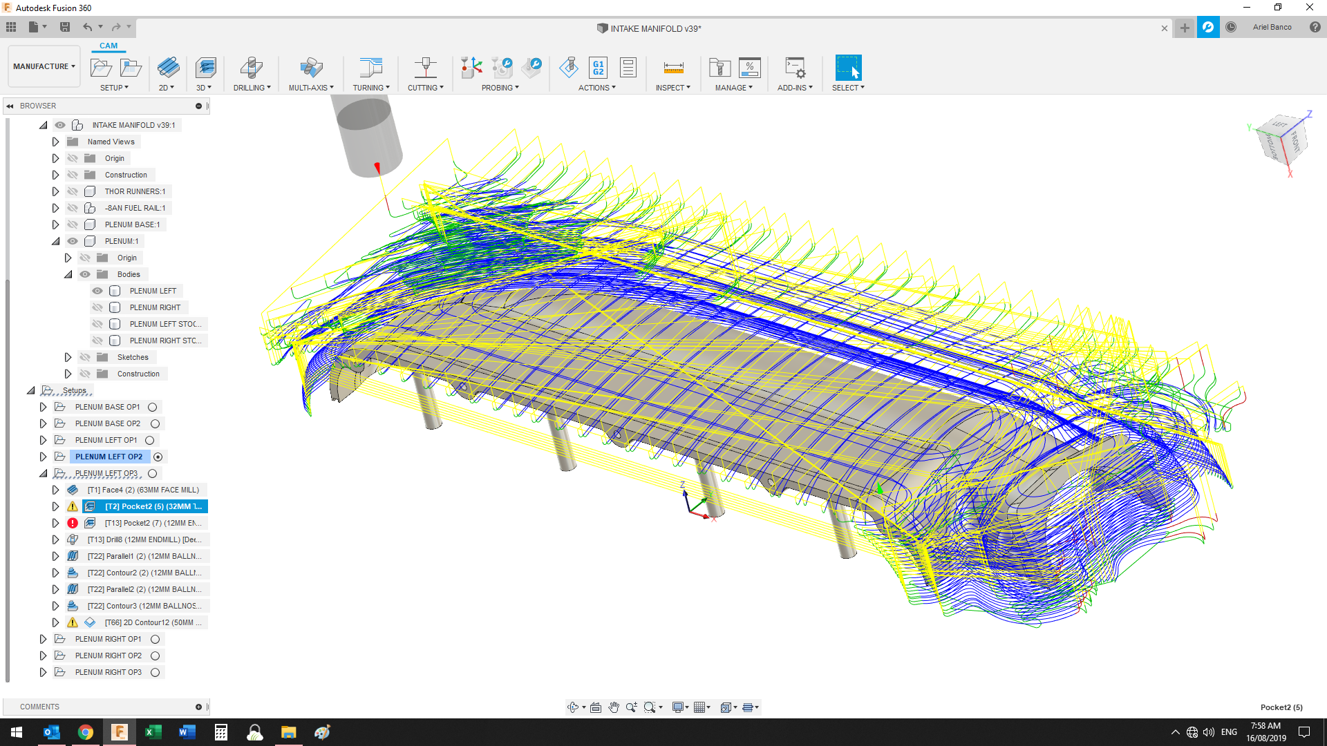

I had a look through some old posts and there were comments about it being removed and then reinstated, thanks to @Anonymous
I follow the NYC CNC procedure but the rest rough operation ignores the "from file" STL and results in just a normal roughing operation without consideration to the STL.
Is anyone else experiencing this?
Screenshots attached of operation "2" & "3"

Same issue since reinstated,

daniel_lyall
It is still there did you have the stock turned on when you ran the sim to get the stock model

Ariel
Yes  I sure did. I went through all the operations and regenerated them and still no luck

seth.madore
Is this a file you can share?
