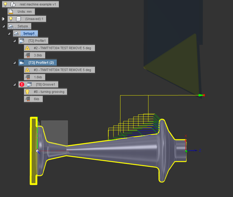

Rest machining appears to not be fully working when turning and therefore a lot of time is wasted.
I have apart that is reduced in the middle, I clear a lot of material out with a triangle tip and then move to a grooving tool with a R1.5mm tip,using sideways turn groove.
The grooving tip spends a lot of time cutting material that has already been removed in the previous op, the rest machining option is turned
on.
Any ideas?

HughesTooling
Seems to be a problem with grooving, if you set up a tool to cut from back to front it works fine.

Message 5 of 10
How odd, if you set grooving to be full step down instead of sideways it also works.
Surely this is not by design? - Will report as a bug.

jeff.pek
This does appear to be a problem in the software. We are investigating.
Thanks for reporting.
Jeff
Message 8 of 10
jeff.pek
We have confirmed this as a defect, and are tracking it with CAM-6899. We should be able to work on this soon.
