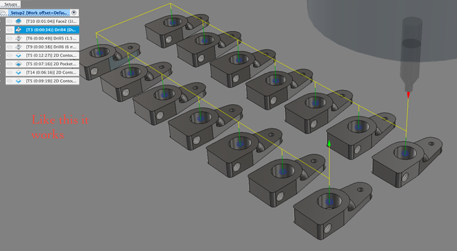

Just when things were going well.   Multiple freezes in creating toolpaths, got past that.
For some reason i cant post a usable  code anymore.   First i somehow  lost the post processors i was using. managed to find them but they dont come up automatically as they did previously.  I have to pick them from the cloud.
NC Failed is the error when i post the code to my usual folder.   Tried many times.
Where should i look to solve this?

More details need like a screenshot of the error, the model that has the problem To attach a file Go to File -> Export and save as a .F3D Archive File and attach it to your next post, if you can not post the file you can PM it to me or say in your next post you can not post the file and one of the Guys that do NDA work will help.

I get Failed File in my output folder.  Opening the file it has only part of the Code .
kretallick144
No errors in Fusion.
Just the Failed File error in the faolder its saved in.

Fusion does not like the hight settings and what you selected to use for the second toolpath.

Ahh Thankyou.  all sorted now.
Strange how Fusion didnt how any errors.
