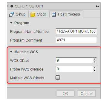

So my G69 issue brought to light the fact that I can tweak the post program.  Every post for me requires me to change a few things.  The biggest is when to turn off the coolant and when to turn it on.  I do not have a full enclosure so I need to turn the coolant on/off much lower.  I do it at Z 2. and add a 1 second dwell.  Also I need to turn off the coolant at Z 0.6 right after the section ends.  This is a real bummer for ops that have say 5-6 tools and changes involved.  Can I make these changes to always be added in my post processing?  Also can I remove the addition of G54 after every tool change?  I don't ever use G54 since it is dedicated to setting my tool lengths.
Thanks in advance.

Do you use G55 instead?
Attach a simple text g-code file showing exactly where you want what (in RED FONT for clarity) and those edits can be done fairly easy

I had some time while I ate my breakfast, so I made a few edits to a stock Haas post.
G69 removed (you had that already)
M8 moved to after the G43 line with a dwell thereafter. Not certain how long a dwell was needed, so I will show you how to change it later if needed
Work offset will now be incremented one spot up. If you leave it set to "1" in the setup, it will post out G55. If you set it to "2", it will post out G56.

Wow thanks.  I use all kinds of settings.  G55-57 as well as G110-G129  Often I have all three vises with a different op in each one going.  So essentially I only want it in the opening of the program so I only need to change it once and not after every tool change.
I was looking for a dwell of just 1 second to give the coolant a chance to get going.
I also need the M09 moved to just before M5 before the tool change is going to happen.  Here is a quick one that I made the edits on the dwell time, M9 and rmoved the extra G55

Message 7 of 10
LibertyMachine
To your second question first. The Setup is where you put your workoffset. In your case, a "1" would yield a G55, "2" a G56, etc etc
A Fanuc works just fine with G53. In fact, I much prefer it over the old style G28
Seth Madore
Owner, Liberty Machine, Inc.
Good. Fast. Cheap. Pick two.
