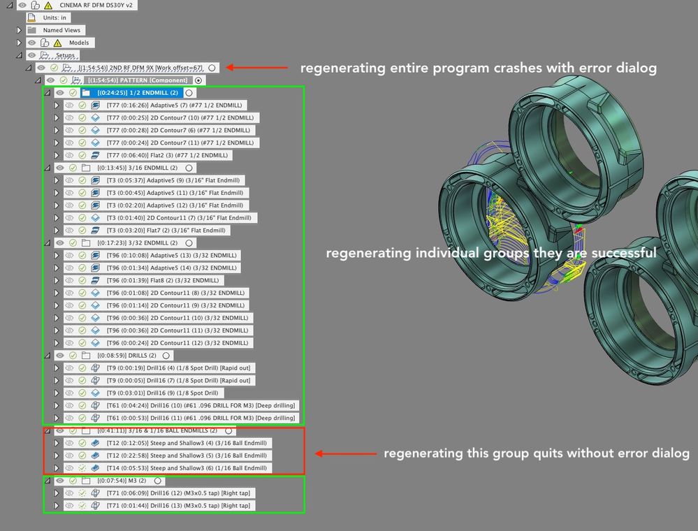

After the new update, we're dealing with perpetual crashing or perpetual application hanging.
One machine in our shop appears to have a previous version of Fusion 360 which is the only machine we can successfully use at the moment.
I noticed that regenerating the entire program crashes with an error dialog.
Regenerating only the Steep & Shallow group Fusion crashes without error dialog.
In the attached video below you can see the same program regenerated on two different computers, one using a previous version of Fusion and one using the newest update.
A previous version of Fusion does not crash, it successfully regenerates the simple program.
After the update most of our programs cause Fusion to perpetually crash or hang, but not all of them, only like 80%.
I have copied the program in the video in a Fusion Team folder.
Can I have the email address of someone who can take a look at the program as an example of how the new update perpetually crashes Fusion?
Currently we are unable to machine new parts. If anyone can help us to please get back to a functional state please call me 24/7 at 707-490-5445.

If you create a super-simple model, say with just a setup and a facing operation, are you still seeing a crash?
Jeff

jeff.pek
Also, do you have auto-generation of in-process stock enabled? If so, can you disable that, and see if you continue to see these crashes?

jeff.pek
Please help us help you. What are you doing when it crashes? Can you attach a model with steps to reproduce?
