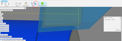

Is there a feature that allows you to measure between the tool paths and your 3d model? This would make it easier to see how far a tool path moves towards the edge of the model, for example. I have worked with another CAM system where this was possible, and it is a very useful feature. If it is not possible, perhaps it could be built in?

programming2C78B
between this
and this (right click toolpath > "Toolpath Data")
you should be good.
