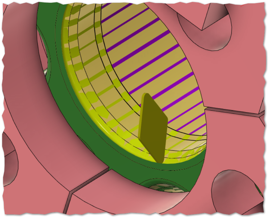

Good day, everyone.
I have some issue, with the creation of a comertial tool, and the programing of a special feature.
The choice of tool is from Sandvik, (A12S-SDUCR 2-ERX), with the insert DCMT 07 02 08-PM 4335.
It is possible to create a new tool with the selected configuration?
I´ve getting troubles to configure the virtual tool, and generate the desired path.
Here you´ll find some images to illustrate the doubth:

Unfortunately, I don't believe that such a tool and turning strategy is currently supported in Fusion. Let me check with the turning team and get you a definite answer though
No, it's not possible, sorry. Confirmed with the turning team.

That said;
If you turn off the holder and play with the orientation, you should be able to accomplish this.
The tool orientation or set-up angle would need to be used to adjust the seated angle of insert since the holder is no longer there. Set-up preferably should be used.  If it's like a 55 degree insert the set-up angle is 90 degree's with an orientation of -27.5 for the seat angle of the holder + -3 which is the tool lead angle, so -30.5,

your best bet may be disabling the "holder" in your setup and configuring the insert alone to the corresponding angles.

Seems to be the desired solution, I'll be reporting the results!Solution.png
