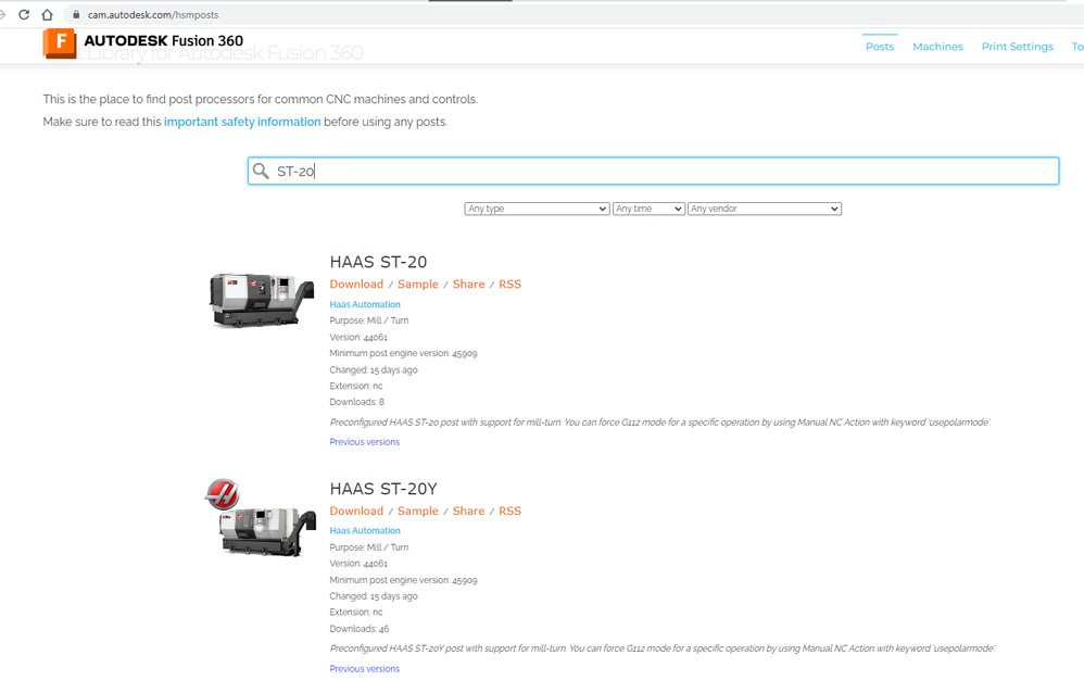

AUTODESK HAVE A MILL TURN POST YET FOR HAAS ST20? I see a generic mill-turn machine in setup but what post would I use?
0 个赞
7 条消息(共 37 条)
seth.madore
Yep, we got em:
There are no machine configurations yet, since Machine Simulation does not yet support lathes or Turn/Mill machines.

seth.madore
Oh, you most certainly CAN use the post processors to program a turn/mill lathe! You just can't use Machine Simulation (just regular simulation)

JamesCipolloni7683
Where is the post ? I'm not finding it?
0 个赞

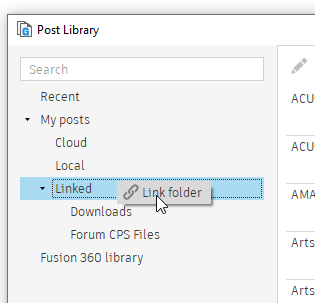

seth.madore
Inventor/HSM and Fusion use the same post processor. You can find the ST-20Y Post Processor HERE
Download it to your computer and link the location of the post in your  Post Library:

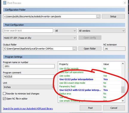

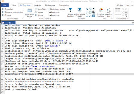

JamesCipolloni7683
What am I missing here?  It fails when I run the post see below , is the manual nc correct?

seth.madore
Does it succeed if you don't include those Manual NC commands?

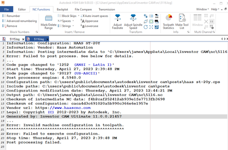

JamesCipolloni7683
the failure is similar but not the same
Are these setting correct?

seth.madore
No idea. Could you share your solid model here? I'd ask you for your Fusion file, but you're using Inventor. Has your company decided against going with Fusion 360 for your design and manufacture needs?
