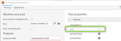

serge.quiblier
Hi @jwmodel
have you tried to change the value of a post property, "Use ISNC or BNC mode"?
You should start by trying that.
By default Hurco machine can run code in one of two mode.
But the older machine like the BMC were only running in BNC mode.
Try setting this property to false
Regards.

Hi @jwmodel
This is not very complicated, you just had to edit the post using a text editor.
(Notepad, notepad++... but not Word and alike)
Then change this code
  optionalStop: true, // optional stop
  isnc: true, // specifies the mode ISNC (ISO NC mode) or BNC (Basic NC mode)
  separateWordsWithSpace: true, // specifies that the words should be separated with a white space
into that code
  isnc: false, // specifies the mode ISNC (ISO NC mode) or BNC (Basic NC mode)
Or else, just changing it once at posting time, to test, then edit the post if the code run successfully.
Cheers

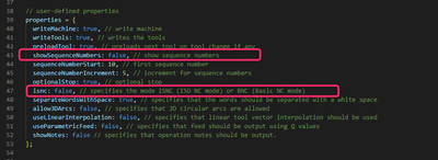

So, here is the modification I am suggesting to your post processor.
Open it with a text editor, like notepad.
In the beginning of the file, look for the properties definitions, and change the ones highlighted.
As we don't need the lines numbers, and the machine is running in BNC mode.
Then look for the onOpen function, and we will have to delete some lines at the top of the function:
Delete all the lines in the framed section.
This will remove the program number.
We will then move to the end of the post processor at the very bottom, to remove the M61, and the G69.
After deleting this line, we will delete another one below:
For the E at the end, I think it was the line number that was inappropriate.
Regards.
