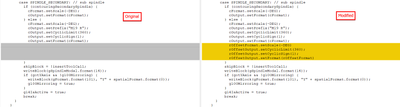

 Modification 4:
Finally, add this last block of code into your post (check the fourth screenshot for the specific location):
  rOffsetFormat.setScale(-DEG)
  rOffsetOutput.setCyclicLimit(360);
  rOffsetOutput.setCyclicSign(1);
  rOffsetOutput.setFormat(rOffsetFormat)
After you've made these modifications, select the post again. You should now be able to see a new Variable called "R Offset value". Any values added in the field will be included in the output as shown in the final screenshot.
