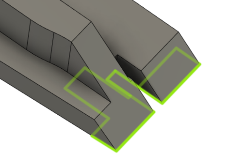

I recently made a 4-sided case and used a new technique for the mitered corners. I've used the 90-deg v-bit trick before, but I don't like the variability in re-zeroing after a tool change, and I wondered if I could get away with a parallel toolpath using the 1/4in bit used for everything else. It worked great! ...
...except it cut into my part in the surrounding area during the operation. Like all things I suspected myself, but I just looked more closely before I go to make a second, and it looks to be real in the generated toolpath.
Can anyone illuminate on why it would generate a path that cuts into the final model?
Here's the part for reference. I will note that this was made in SolidWorks and imported to Fusion. Not sure if that matters or not.
Here is the parallel operation cutting my miter:
I adaptive clear to rough everything out, then run the miter parallel toolpath, and then clean up the "shelf" and walls with this 2d conI also have this contour cleaning up the "shelf" and protruding walls after this miter operation:
Now I'm orienting to the front view (looking at the miter/shelf from the side) and zooming way in:
Here's the contour, which makes that shelf disappear behind the toolpath lines:
Now here's that parallel path highlighted, which is clearly below the shelf as I experienced in real life:
Here's the geometry tab, which I'd think is the most relevant?
I thought it might have been the use of touch surfaces, but here's with turning them off. In this view from the side, you can see the toolpath line disappear right into the part!
Any other information that would be helpful for me to provide? All other cuts/passes seem correct, and in checking other dimensions, things seem well within what I'd expect. My walls should be 4.37mm and I get 4.34-4.37mm with my caliper away from the ends, but 4.19-4.22mm where the parallel path hit.
I appreciate any suggestions, and again am happy to provide other details/settings that would be needed to troubleshoot further. I've never had this happen so I'm not sure how to diagnose!

I saw your issue from the start, I solved it in two ways but then we got into..... "why does Fusion!?"
Because you used odd tool choice to do something, there are consequences that need to be dealt with, that's not workaround, that is simply counteracting result of bad choice, one that would not be within preferred choice of tool for type of operation but still works within narrow margin of side effects that need attention.
Fusion has more than one way to do nearly anything, only limited by bugs, lock of full development, user's skills and imagination.
Here is one way again, flat end mill, tool overlaps edges of model by 1 mm, tool does not go below model bottom, absolutely no intrusion into unwanted surfaces as you can see, Fusion rocks. 😎

Along with studying the Z positions whilst running the simulation and also cross referencing the Z positions output to the ISO program I can see that Fusion is doing everything correctly, all Z heights in the problem areas are within 3 microns, ie. 4.375mm on the step and 12.500mm at the top surface. Fusion is not to blame.
In your file when  I run the second parallel toolpath I can see(as in your second picture) that the tool runs over onto the top and stepped surfaces as you have indicated where the problem is.
Could it be possible that it is merely a matter of the tool running over those areas many more times than the full length areas? Taking a few more microns with every .5mm stepover?  We would even see a mismatch here on metal but I imagine it could be worse on wood. On aluminum with a precision ground sharp tool generating as little heat as possible we would probably get the minimal show.

I projected my own machining boundaries on to a sketch and then moved them the by the radius of the tool length ways along the model and added .5mm to the width ways profile and this seems to be giving a nice result.
Previously when trying to achieve something a little out the ordinary tooling wise I have had to created my own boundaries to get the result I was after.  A little bit more programming work involved but this has even been the case with the other CAM packages I have used.

Here's a quick screencast showing how to create extended surfaces so you can over machine the angled faces. Same as I suggested in the other thread. Note, it's a good idea to reset the extend surface tool to zero after the first selection to make it easier to select the other edges.

I was gonna pass but could not resist, so..... the screencast does what it does, creates dummy surface to be used as geometry to cut, you filled the vacuum I deliberately left behind for operant reasons and I have no issues with that.
But, for wider audience, I wanna point out two things about the way you used option in this particular case.
1- Extending  bottom edges is not necessary because of flat end mill being used, OP had an issue with using ball end mill because it would cut into his spoil board, very upsetting part of "wrong vs right choice of tool" as we have seen.
2 - The main reason for creating offset surface is to isolate main body that caused odd tool path or "tool eating the model" under certain choices made in operation.
Therefore, when selecting model in operation, in this particular case, you wanna unselect option to use setup model which results in only machining duplicated surface.
Operantly, because you extended top edge of new surface, tool still avoids "eating the main model" even though you left setup model selected in operation.

@jw.hendy  No problem. All I did was project the face of your MITRE on to a new sketch plane (See Pic) then the outer profile will show as purple in color. After that you need to delete all constraints to change it to blue lines that you can then manipulate to achieve whatever boundary you are after.
If some body has advise of how to project a profile without constraints please share!
