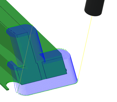

I recently made a 4-sided case and used a new technique for the mitered corners. I've used the 90-deg v-bit trick before, but I don't like the variability in re-zeroing after a tool change, and I wondered if I could get away with a parallel toolpath using the 1/4in bit used for everything else. It worked great! ...
...except it cut into my part in the surrounding area during the operation. Like all things I suspected myself, but I just looked more closely before I go to make a second, and it looks to be real in the generated toolpath.
Can anyone illuminate on why it would generate a path that cuts into the final model?
Here's the part for reference. I will note that this was made in SolidWorks and imported to Fusion. Not sure if that matters or not.
Here is the parallel operation cutting my miter:
I adaptive clear to rough everything out, then run the miter parallel toolpath, and then clean up the "shelf" and walls with this 2d conI also have this contour cleaning up the "shelf" and protruding walls after this miter operation:
Now I'm orienting to the front view (looking at the miter/shelf from the side) and zooming way in:
Here's the contour, which makes that shelf disappear behind the toolpath lines:
Now here's that parallel path highlighted, which is clearly below the shelf as I experienced in real life:
Here's the geometry tab, which I'd think is the most relevant?
I thought it might have been the use of touch surfaces, but here's with turning them off. In this view from the side, you can see the toolpath line disappear right into the part!
Any other information that would be helpful for me to provide? All other cuts/passes seem correct, and in checking other dimensions, things seem well within what I'd expect. My walls should be 4.37mm and I get 4.34-4.37mm with my caliper away from the ends, but 4.19-4.22mm where the parallel path hit.
I appreciate any suggestions, and again am happy to provide other details/settings that would be needed to troubleshoot further. I've never had this happen so I'm not sure how to diagnose!

Tool overlaps selected faces because you are using flat end mill and "Tool center on boundary", tool center is what it is and because it is flat end mill, tool overlaps edges by its radius.
Typically, you wanna use ball or bull nose end mill to do any 3D finishing work, bull nose will not be good choice in some instances just like case in point with flat end mill.

I guess I find that explanation odd? This isn't about not "overlapping," it's about the z height it uses for a plateau after the ramped section being below a model surface. A 3d contour doesn't do this, despite being a 3d path. I get that this is "atypical," but Fusion is also well aware of the tool geometry, and it's not about the outer edge of the cutter hitting a vertical wall, it's about the tip being buried into the part.
Actually, I just tried using a 1/4 ball end mill and the same thing is happening. It seems this is about the z of the tool being too low (which affects a ball or flat end mill equally). Look at how those toolpaths are well below the shelf:
You can see the toolpath disappear into that area again after switching to a 1/4-ball.
Maybe a side question: regardless of the boundary chosen... are you saying Fusion will readily generate toolpaths that create a situation where the tool volume (e.g. a 1/4 cylinder in my case) readily crash/collide into the model? I have certainly run into issues where the wrong boundary type won't reach a given area (e.g. choosing center and I want "outside" so it cuts a perimeter), but I've never had the selection dictate that I must cut my actual model surfaces?

It seems I've riled you up. I didn't meant to. I read your explanation, didn't think it answered my question, and said so. There are now two topics going on: my original inquiry, and your assessment of the validity of what I'm doing.
The actual question
Fusion generated a toolpath where the tool is machining into my model, both in theory (Fusion shows it) and in practice (my machined result). I want to understand why this is the case, and if it's potentially a bug. Your response about the horizontal boundaries of the machining area did not satisfy me. This is about the height of the path.
I'm still looking for some explanation and/or solution to this:
I can understand how the "wrong tool" would yield a subpar machined result, but I expected and have experienced Fusion to always err on the side of leaving more stock. Thus, the "garbage result" you hypothesize will be due to excess stock or poor surface finish. Are you saying it's quite expected that Fusion will readily machine into the model?

You are using the wrong tool for the angled faces flat yes sure but that big of an angle needs a ball nose or bull with a tinny step over there is no way around it yes it looks fine but you can see the toolpath lines A bull would have done a better job.
This looks good but the sim is only a Guide
A back plot looks good
Where the arrows are pointing is the problem there is a difference between the first and second and the first is the problem, why is there a difference

Thanks for taking a look. Could you clarify this? "Where the arrows are pointing is the problem there is a difference between the first and second and the first is the problem, why is there a difference"
I'm not sure what you are highlighting or explaining.
Re. the "wrong tool," could you define this more explicitly? As in (a) "a tool that will machine into your part when used in a parallel toolpath" or (b) "a tool that generates a poor surface finish?" I'm only interested in (a). I get the theory behind (b)... but it's my project/part, to my knowledge I'm the only one who's cut this in real life, and I'm saying I'm happy with it. Try to cut it with my settings and have a look yourself..
I'd just like to understand the machining into the surrounding material, where the z height of the parallel toolpath is lower than the z path of the contour toolpath.

Each type of tool has a standard use flat for a flat round for round yes you can do other things with them that's a given.
I asked about machine you have as most have the option of adding probing If you did just for the Z things will be easyier
Your first parallel toolpath is set to cut these faces so it is doing just that cutting those faces and bugger anything else and on your pick where the part is cut too deep it lines up with the toolpath(What I was pointing To), this could be your machine losing steps or fusion being silly.
To sort this you will need to run the toolpath again done how you have done it and done how I have done it.
The standard to do the angled faces is a V bit, ball, or bullnose or custom shaped cutter for a custom shapes the reason for this is the surfaces that get cut if it is to a speck the chances of it failing is massive if you just use a flat endmill visually it may look fine but it will be bad it is all to do with the shape of the cutter if you do it for roughing a part that's fine I do that on a bevel for something I make then I come back and clean it up with a ball nose end mill the reason I come back and do it with a ball nose is the endmill leaves cusps you can really see it when it is sanded so to get a good surface it has to be done with a ball noise never tried it with a bullnose. future more it's faster with a ball nose
The sim is showing the cusps with a flat endmill
You can do it however you want if you are happy with the finish go hard but you should expect to get told the standard way of doing things
The standard is if it is a flat surface being cut use the toolpath that is made for it the top flat faces of your part are flat so using a toolpath made for cutting flat surfaces will be faster as that's what they are for so taking this the 3rd toolpath to cut the flat areas you are using the parallel toolpath what's also going down the miters 6.06 min if you use a 2D pocket its 2.36 mins for the flat areas then if you do a parallel with a ballnose after just on the angled surfaces its 1.26 mins total 3.62 mins instead of 6.06 mins and the parallel toolpath has a .1mm stepover. You can just change the first parallel to a selected toolpath and turn touch faces off you could even set it to a .1mm steppover what will give you below but there is the chances the samething will happen again.
What you said about the ball noise going below the bottom surfaces it does that
I have the attached model how I would do it with a parallel toolpath using a flat endmill set so it only hits the angled surfaces, I changed your first contour so it does the finish it one run.

However, it is possible to cheat the system into compliance despite better choices and here is example of managing wrong tool to do good job.
Yes I am telling you that using wrong tool for the task will result in problems,  but if you do things that promote failure and problems, learn techniques that help you manage bad effects of doing the wrong thing.
Like, if you want to bang your head against the wall, strap a pillow on your head 😁
The "pillow" in this case is a dummy surface with extended edges to avoid tool hitting model where it's not supposed to , but using ball end mill instead is still better choice.
2021-05-17 06_41_11-Window.png2021-05-17 06_44_08-Window.png2021-05-17 06_39_21-Window.png2021-05-17 06_42_48-Window.png
Also, using Selection rather then Silhouette keeps tool edge on selected surface without spilling over.
