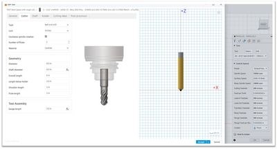

Regarding the warnings, my "Safe Retracts" settings appear to be configured correctly (screenshot attached).
The "Error: Tool length compensation is not active" is the primary concern. My tool definitions seem correct (screenshots attached), and notably, it's the same tool used across all three operations within both G55 and G56 offsets. The log references "Error at line: 2051 (avid cnc.cps)" and mentions operation 'Parallel3', but if I remove that specific operation, the error simply shifts to the next one in the sequence.

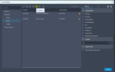

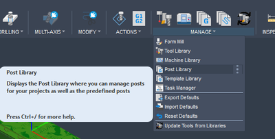

a.laasW8M6T
Hi
The easiest way to do this is to go to the post library and import it to either your local or cloud folder
Then you can select it from your local/cloud folder when you go to post process
