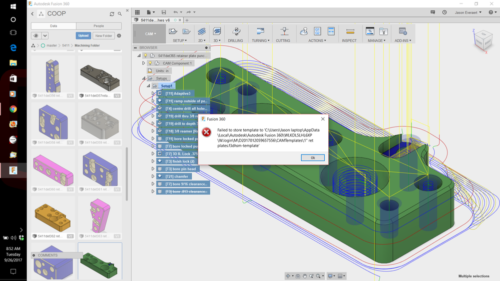

Anyone ever have this?  selected the toolpaths .....right click.....select.... store as template....name it....then this screen pops up

Looks like you are using a double quote (") character in the template name? I think that's probably causing a problem.
See if not including that character avoids this.

Thanks Jeff........that was the issue.
