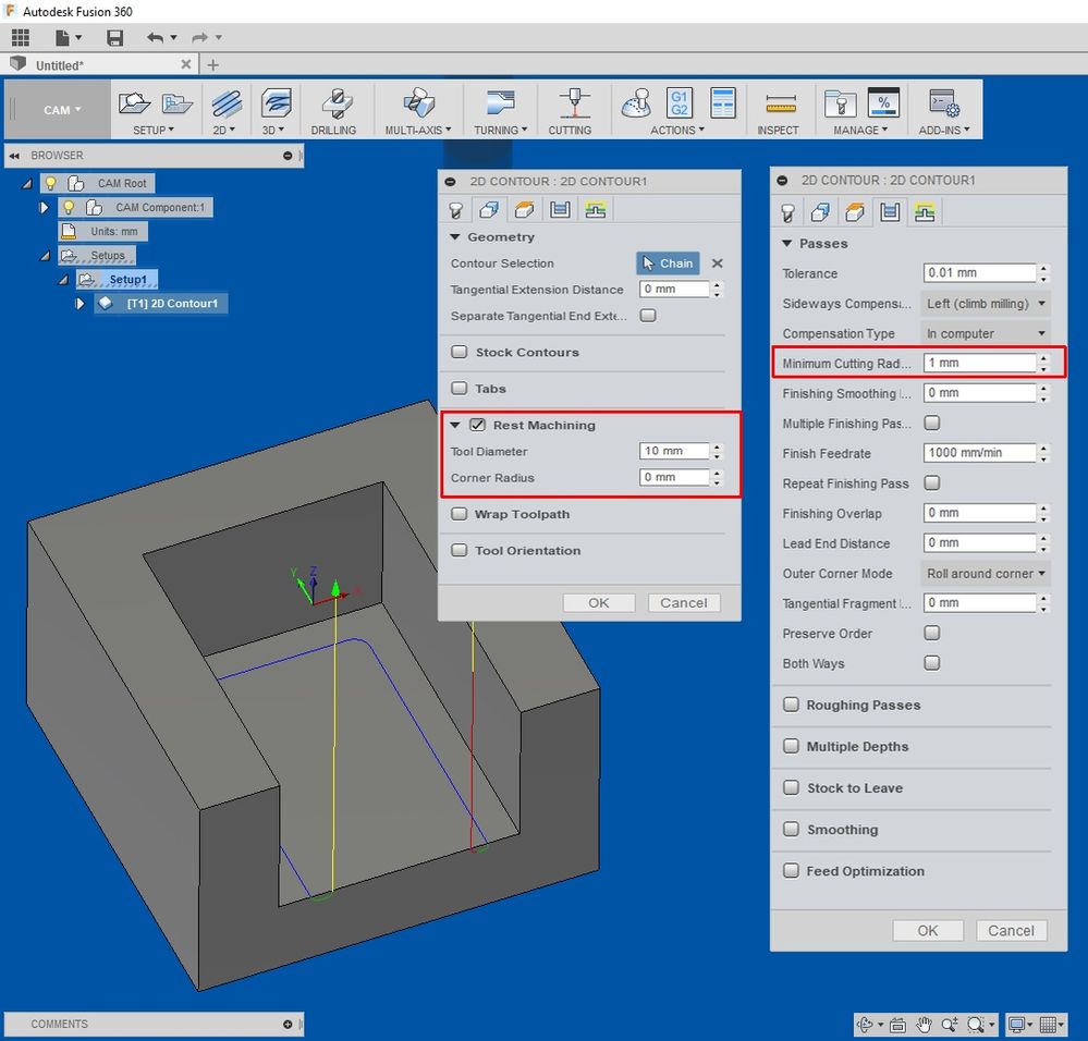

Hi All,
If I make a 2D Contour path with Rest Machining and with Corner Radius the rest area detection always wrong.
The contour goes all of the contours and does not cut it to the right rest area. However, it working well without the
Corner radius.
Thanks for the help in advanced.

Hello @CAMXPRESS and thank you for posting to the Fusion 360 CAM forum.  Have you tried modifying the tolerance in your operation?  Try making it tighter, to something like .001.  Also, if you can, please upload your Fusion file and we can have a closer look.  Thanks!

Hello Matthew,
It is independent about the tolerances. Here is the little project.

Hi @CAMXPRESS,
Thank you for your feedback. It seems to be an issue in the generation and it's logged in CAM-8549.
/Niels

Hi, is there any solution to this problem? It seems the problem still exists after years.
