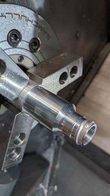

AllanVarcoe
On a positive note, the gauge came out pretty bitchin'!
